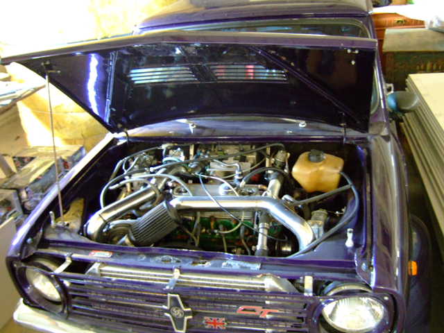

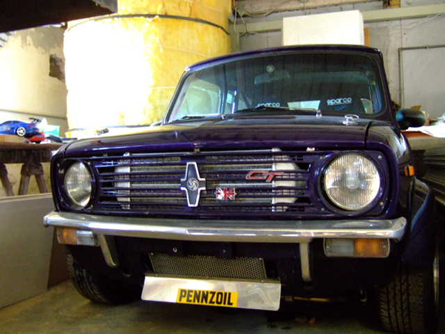

MINI CLUBMAN 1275 GT TURBO 220 HK 27Kgm
Engine / gearbox
Pistons: Omega 73.5 short 11cc (1379cc)
Connecting rods: Lightened no.AGE177
Crankshaft: Forged-EN 40 Bsteel nitrided crank AEG 316
Center main cap: 4 bolt steel
Flywhell: Ultra light 3.8KG
Backplate: Steel special AEG 270 1.35kg
Clutch: Centermetal
Clutch diaphragm: Grey
Cylinder head: Bryan Slark Turbo 36inlet with 6mm steam 29ex with 7.3 stem steel
valve seats in ex. 29.5cc in haed
Rocker: Roller rocker titanium 1.5-1 hi lift
Cam followers lightened 39.7 grams
Cam drive: Kent adjustable steel duplex
Inlet: 5” long alloy miniflod 4030
Fuel injection: Programerbar 4jets 380ml
Distributor: Non
Turbo: Garett T03 Special
Camshaft: kent megadyne 500 road turbo cam
Gearbox: Jack knight straight cut (4014)
Drop gear: Jack knight straight cut 1-1 (24/31/234)
Gear change: Quickshift
Brakes front: Vented metro turbo discs, 4 pot turbo callipers, steel brake hose,adjustable camber, adj koni shocks. Hi-lo kit
Brakes rear: STD 1275 GT brakes steel brake hose, adj. camber, adj. koni shocks. Hi-lo kit
Wheels & tyres: REV 5spk 7x13 with Yokohama 175/50 13
Efektmåling WWW. VHA-TRIM.DK
+ + + + + + + + + + + + + + + + + + + + + + en masse mere MINISOREN@HOTMAIL.COM HVIS DU ER INTERESSERET I AT KØBE

Hvad med nogen tider på 0 - 100 og 400m og hvad er topfarten?
Indlæg: 08 sep 2006, 18:25
Tilmeldt: 09 aug 2006, 11:08
Indlæg: 2
har ikke prøvet 400m mangler dæk og setup topfart 210 kun 4gear 8100omdr
